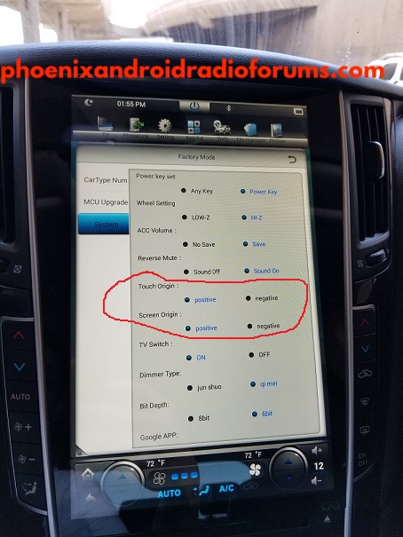

Fix: Upside Down Screen
Check:
1. Settings
2. System Vers/Info
3. Press and hold Information Box - Keypad will come up 7890 ok
4. System
5. Set Screen Origin to Positive
6. Set Touch Origin to Positive
Reset unit by either pressing the RST button with paper clip or turning car off (wait 10 seconds) then turn car on to see if settings have been set
Phoenix Android Radio Fix Upside Down Screen
