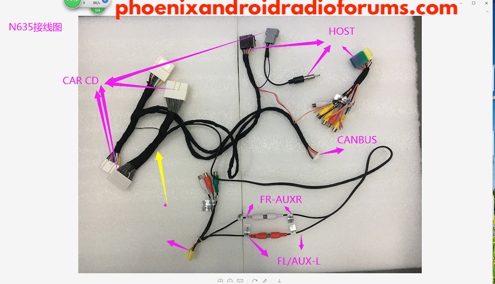

Phoenix Android Radio Manual Install Nissan Pathfinder 1
Phoenix Android Radio Manual Install Nissan Pathfinder 1 (766.37 KiB) Viewed 54549 times

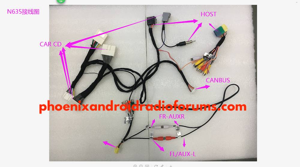

Phoenix Android Radio Manual Install Nissan Pathfinder 2
Phoenix Android Radio Manual Install Nissan Pathfinder 2 (807.91 KiB) Viewed 54549 times

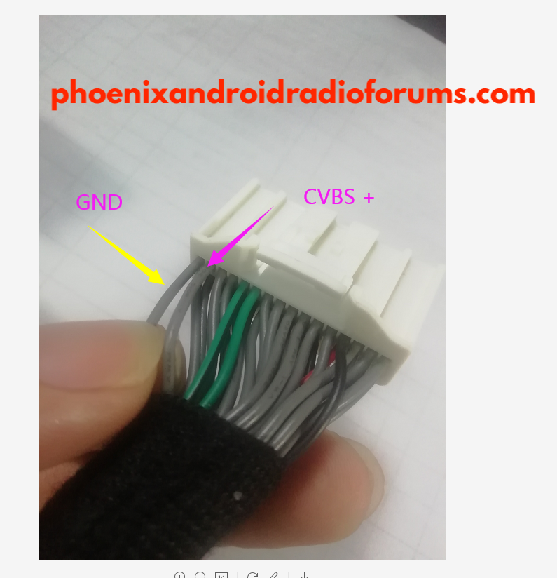

Find the yellow arrow point connector and find the factory backup camera CVBS and Ground Wire. split the wire to the following position wire.
Phoenix Android Radio Manual Install Nissan Pathfinder 3
Phoenix Android Radio Manual Install Nissan Pathfinder 3 (661.12 KiB) Viewed 54549 times
