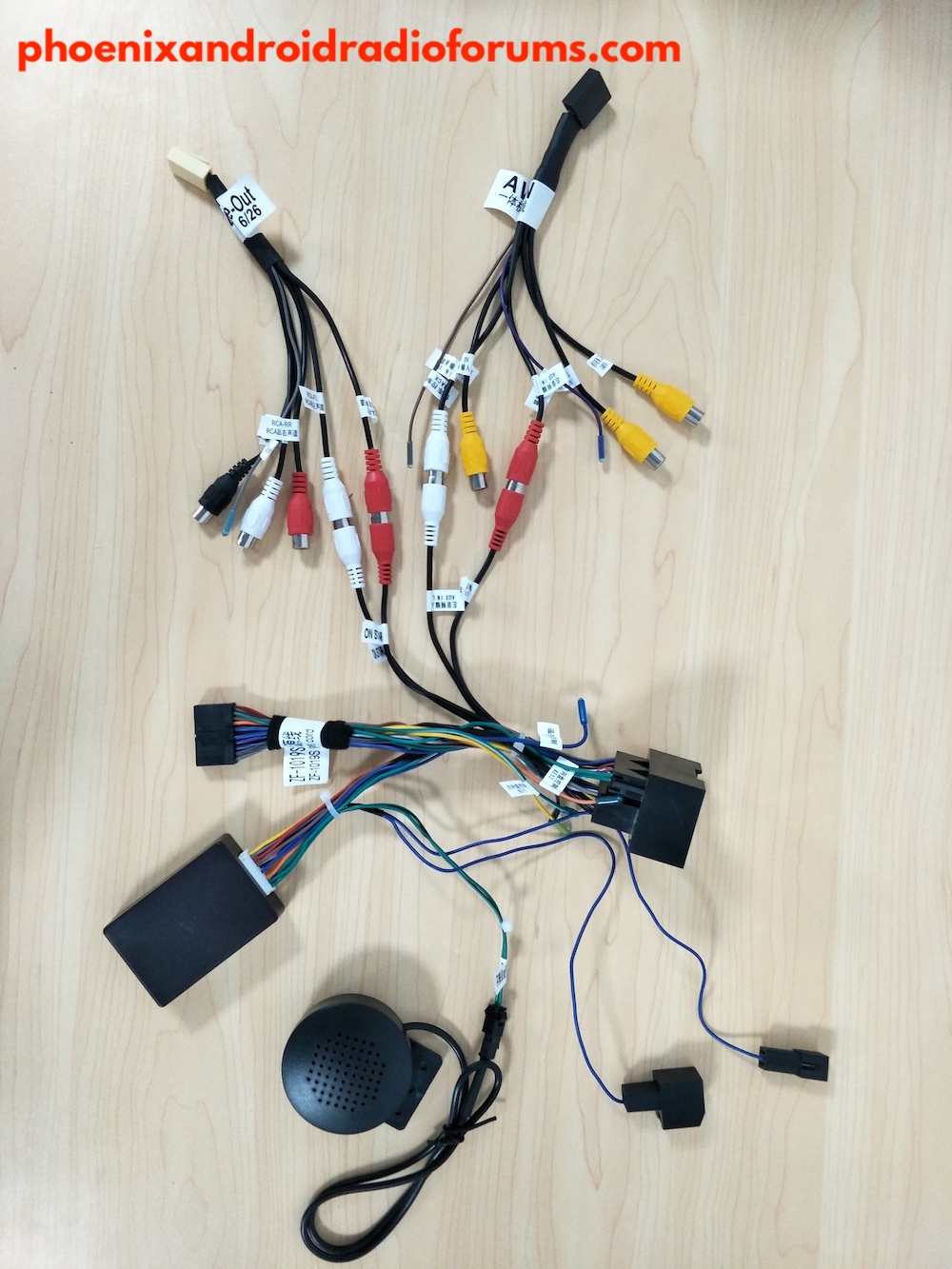

Connect Matching Connectors
Connector with 1 Green wire for Factory AC board connection plug

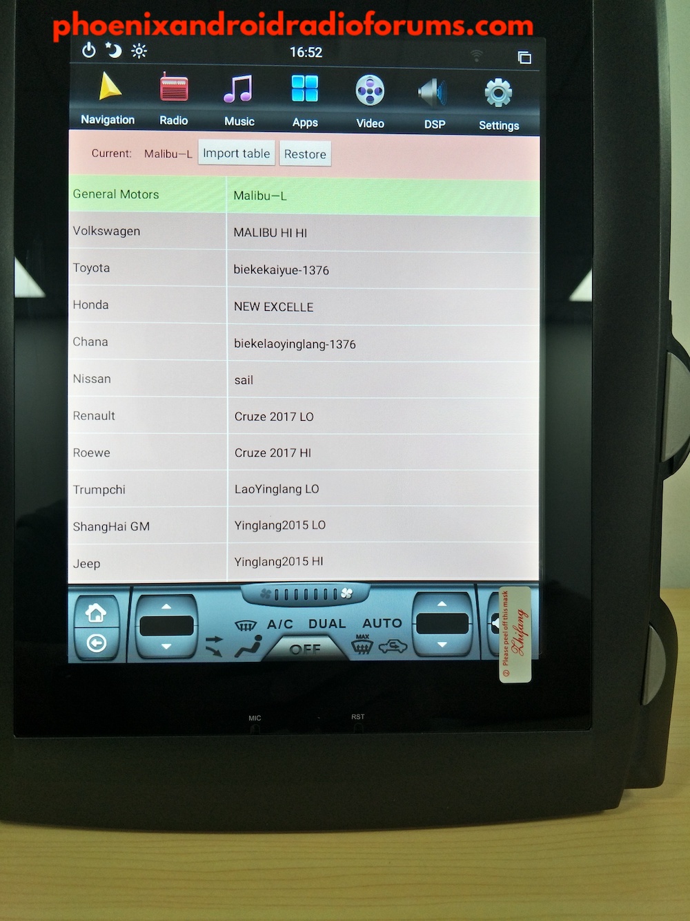

Car type Malibu Hi, or Malibu Lo
Old Min Rui Bao Hi / Old Min Rui Bao Lo
factory setting- password 8888- canbus box- choose BNR-GM-malibu hi- save- pull out the key- waiting for 5 minutes- reboot it
Phoenix Android Radio Install Manual Chevrolet Malibu 2013 2015 1
Phoenix Android Radio Install Manual Chevrolet Malibu 2013 2015 1 (373.66 KiB) Viewed 50595 times

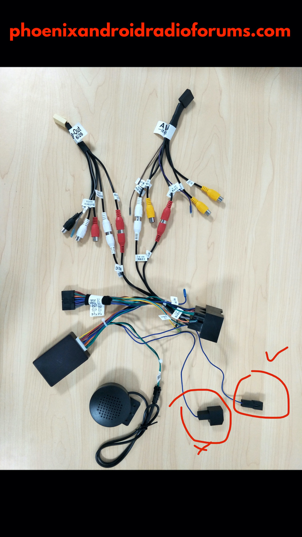

Only connect 1 or the other Plug for AC control (whichever gives more function)
Phoenix Android Radio Install Manual Chevrolet Malibu 2013 2015 2
Phoenix Android Radio Install Manual Chevrolet Malibu 2013 2015 2 (369.78 KiB) Viewed 50595 times
If AC control not working - check if any Fuses Blown - can also plug factory AC control back to see if any error come up when removing and installing new radio
Phoenix Android Radio Install Manual Chevrolet Malibu 2013 2015 3
Phoenix Android Radio Install Manual Chevrolet Malibu 2013 2015 3 (368.39 KiB) Viewed 50595 times
