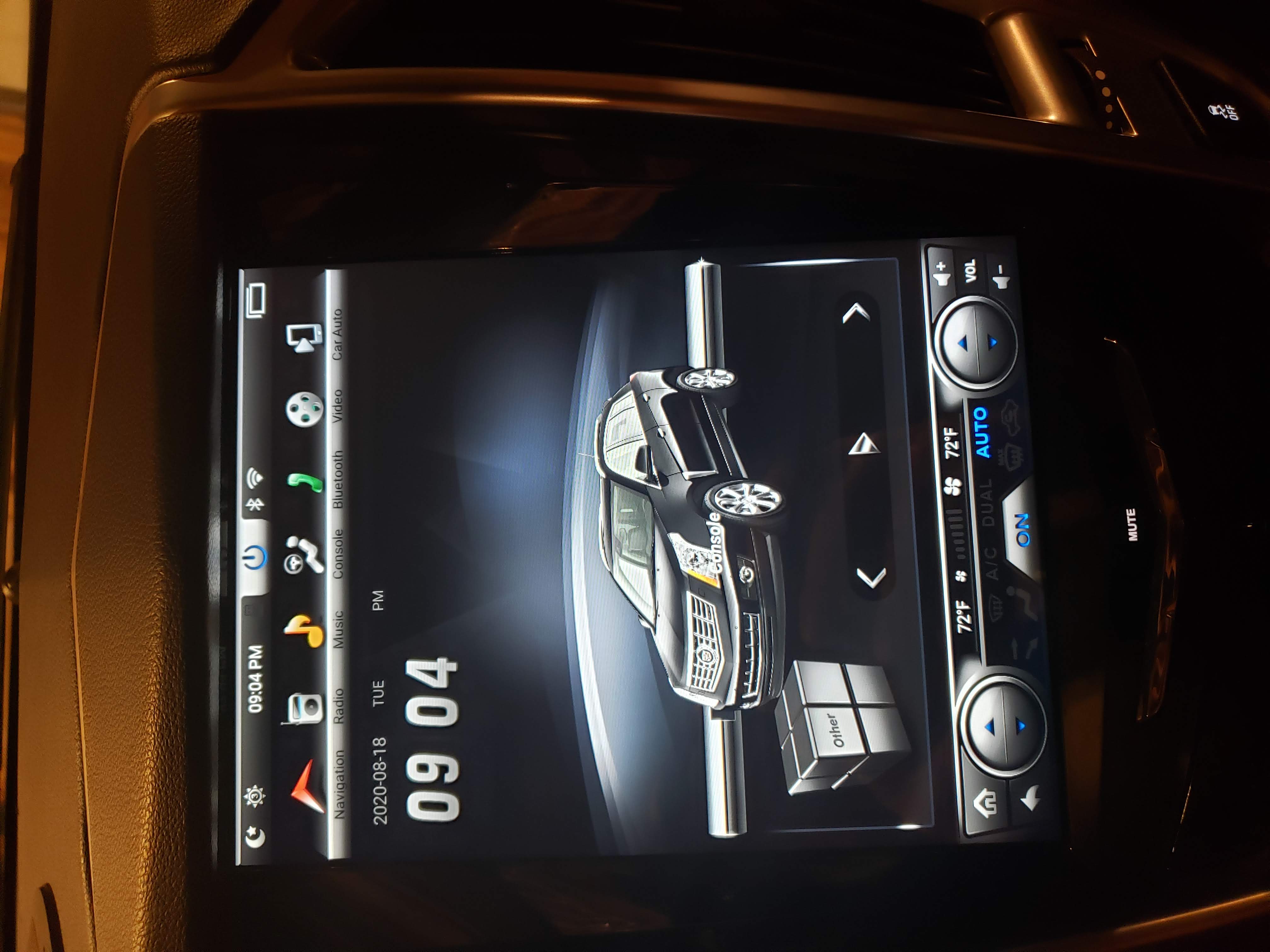

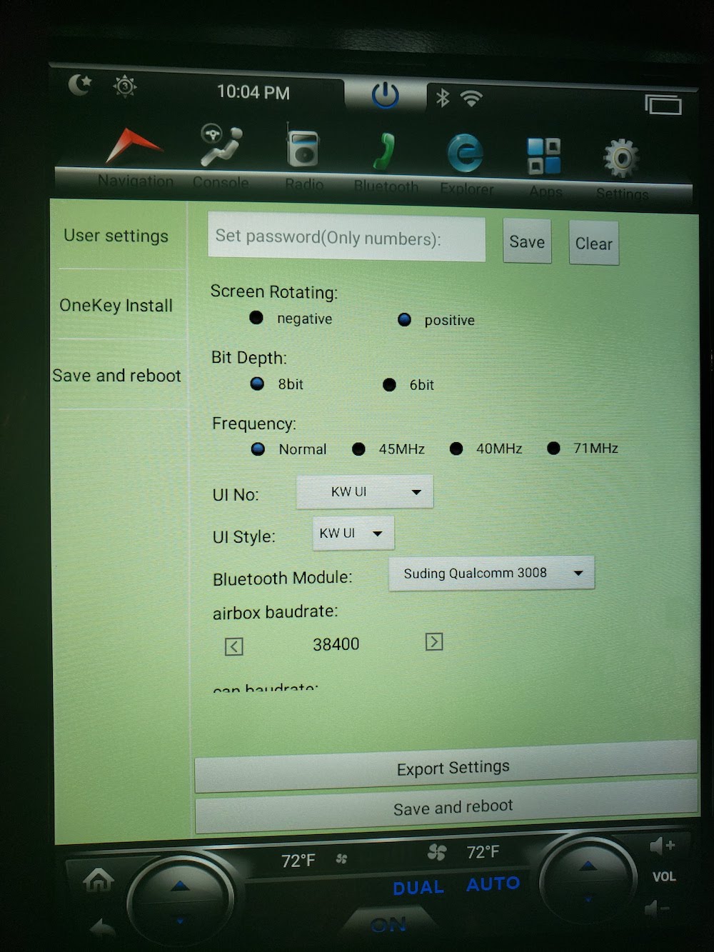

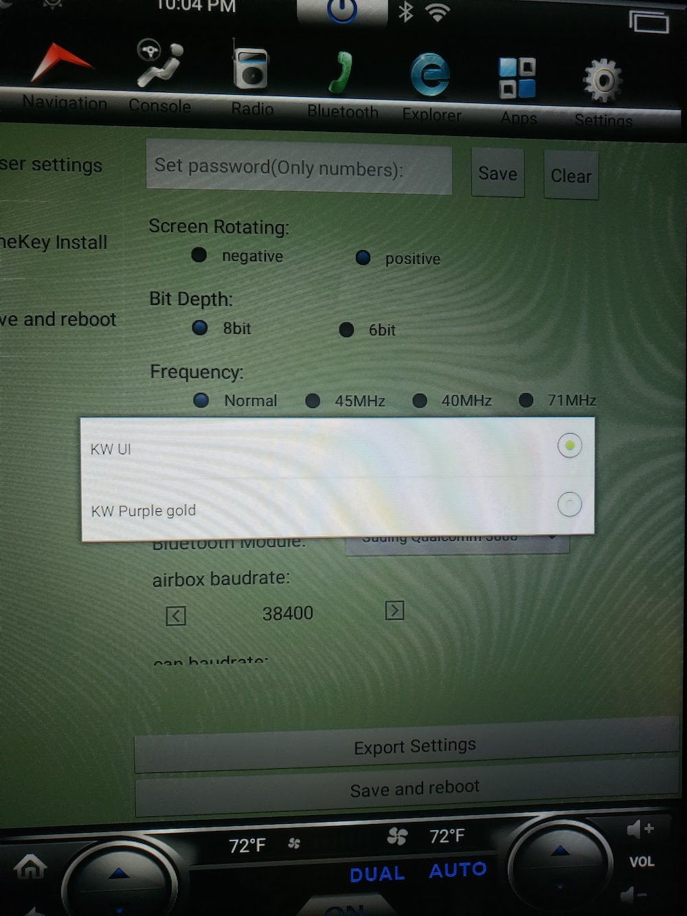

Steps to Remove the Purple Cityscape Image and Calendar from the Home Screen:
Here are the Steps to Remove the Purple Cityscape Image and Calendar from the Home Screen:
Settings
System Info
Long-Hold middle of the General Information Screen
7890 OK
Go to UI No: Change from "KW Purple Gold" to "KW UI"
Save & Reboot
Notes:
This was done on a Px6 unit for 2014 Cadillac SRX; not sure if it works on prior/other models
Boot Logo becomes the Home Page Image
See attached images.
20200818_220433
20200818_220433 (211.12 KiB) Viewed 18567 times
20200818_210432
20200818_220444
20200818_220444 (209.86 KiB) Viewed 18567 times
