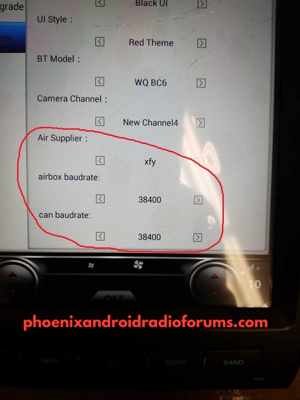

Try to set to 19200 and 38400 with the Protocol XinFeiYang
For 4.4 Android OS Unit
Settings, System Vers/Info, Press and Hold middle of screen - Keypad will come up - 7890 ok, System, can scroll down to the setting below.
After set to XFY, 38400, 38400 need to restart by pressing the RST button with paper clip near the mic.
or turn off car, open close door, turn car back on
Phoenix Android Radio Ac Not Working
Phoenix Android Radio Ac Not Working (107.36 KiB) Viewed 34402 times
