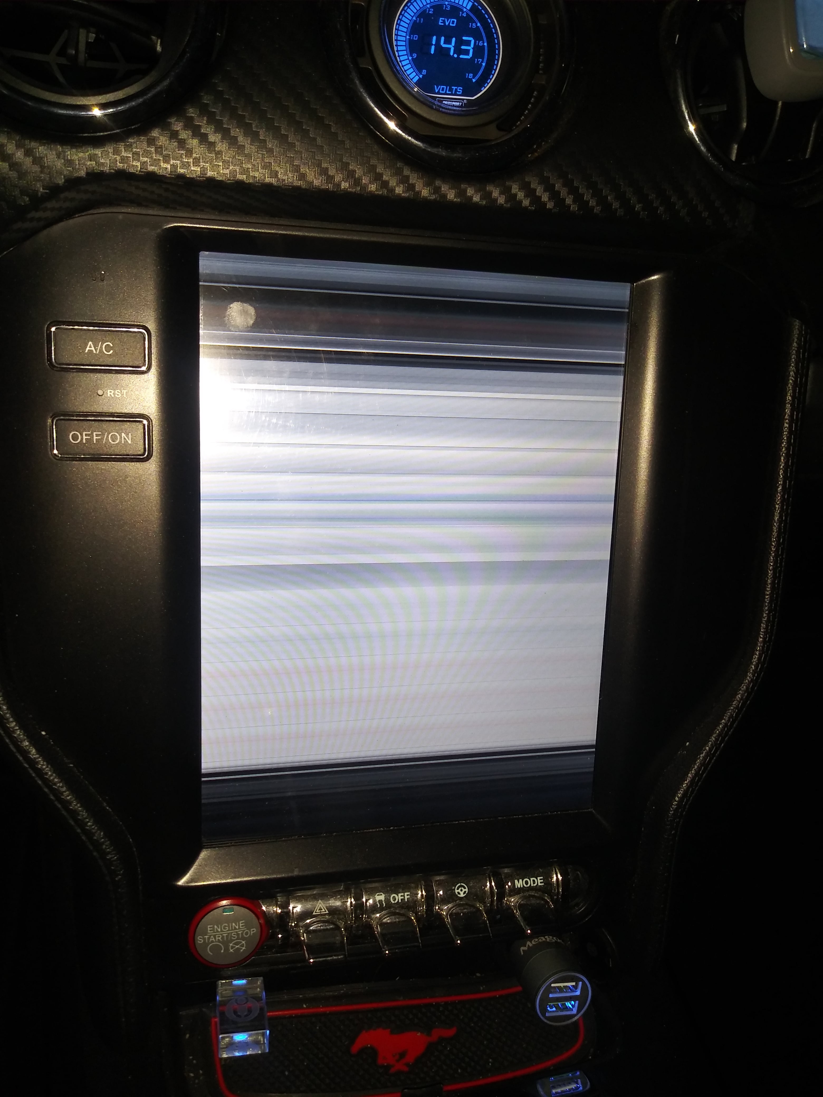

I bought this in February 2019 this started happening intermittently a few months ago. After paying the stereo for a while the screen becomes scrambled. If a turn the car off then come back later it starts working normally, then after about 20 to 30 minutes, this happens. Any idea what could cause this (bad GPU?). Has anyone experienced this before and if so how did you fix it. I did a factory reset on the unit and this still happens. Image
Touch Screen Scrambled Min

Low car battery, low voltage to android, 10v or less. A high voltage like 15v could also damage the screen.
If you happen to have an alternator shaft is creating lots of noise and a low voltage, the noise in the voltage could cause the Android radio to have screen issues.
Check voltages from battery, alternator and I will check right at the back of the radio for the wire that connects to the battery and accessory.
